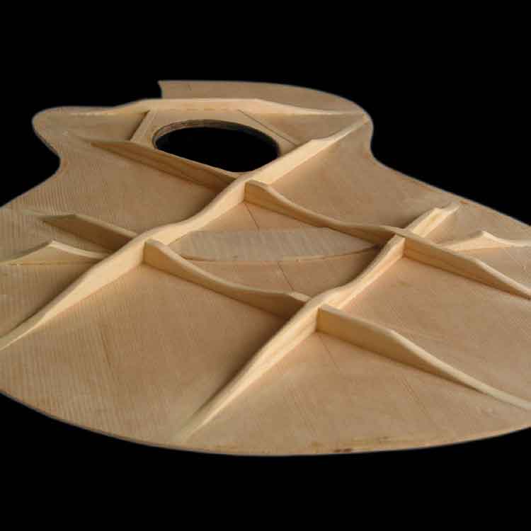

IMO, Paul, you have a lot of wood there, and the scallop of the upper X is
too far forward (toward the soundhole). But if it sounds good and the top
doesn't dip in front of the bridge (wait ten years?), then ignore me.

PostPosted: Mon Oct 10, 2005 5:37 am
Posts: 329
Paul, Is it an optical illusion, or is your bridgeplate dished-out in the center?

PostPosted: Mon Oct 10, 2005 6:13 am
Though I'd love to take credit for that type of crazy workmanship, alas, it's an illusion.
PostPosted: Mon Oct 10, 2005 6:21 am
...thus the reason this top was aborted. But it's all I have pics of.

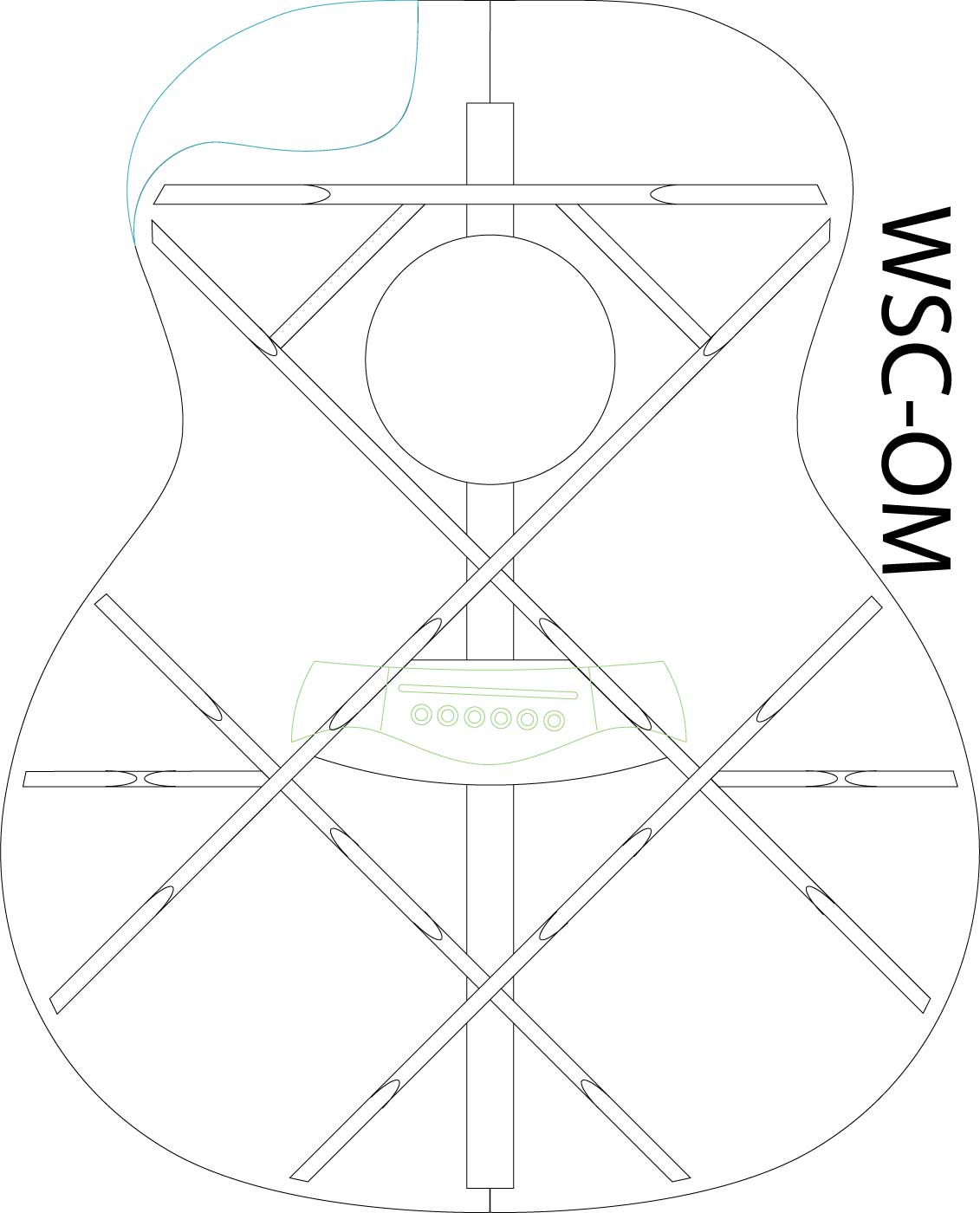

Yes, too much meat and the scallop is too dramatic. Here's a design of what I've been doing with Quad Xs.
